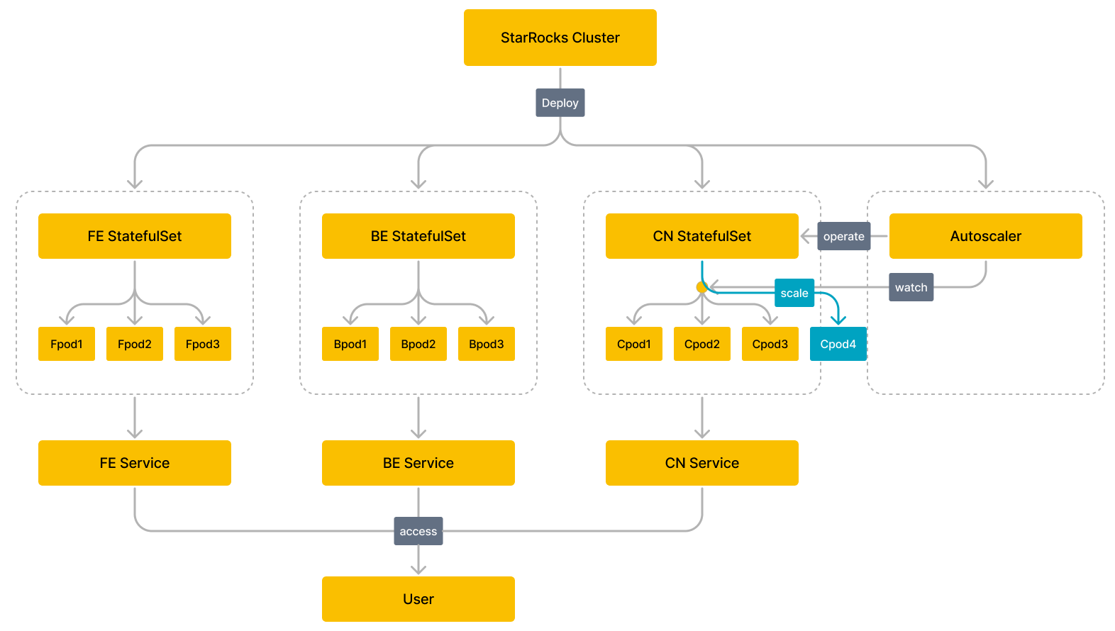

How it works​

The components of the StarRocks cluster can be accessed through their associated Services, such as the FE Service. For detailed descriptions of Services and their access addresses, see api.md and Services.
note
  • Only the FE Service is deployed by default. If you need to deploy the BE Service and CN Service, you need to configure starRocksBeSpec and starRocksCnSpec in the StarRocks cluster configuration file.
  • The name of a Service is <cluster name>-<component name>-service by default, for example, starrockscluster-sample-fe-service. You can also specify the Service name in the spec of each component.
