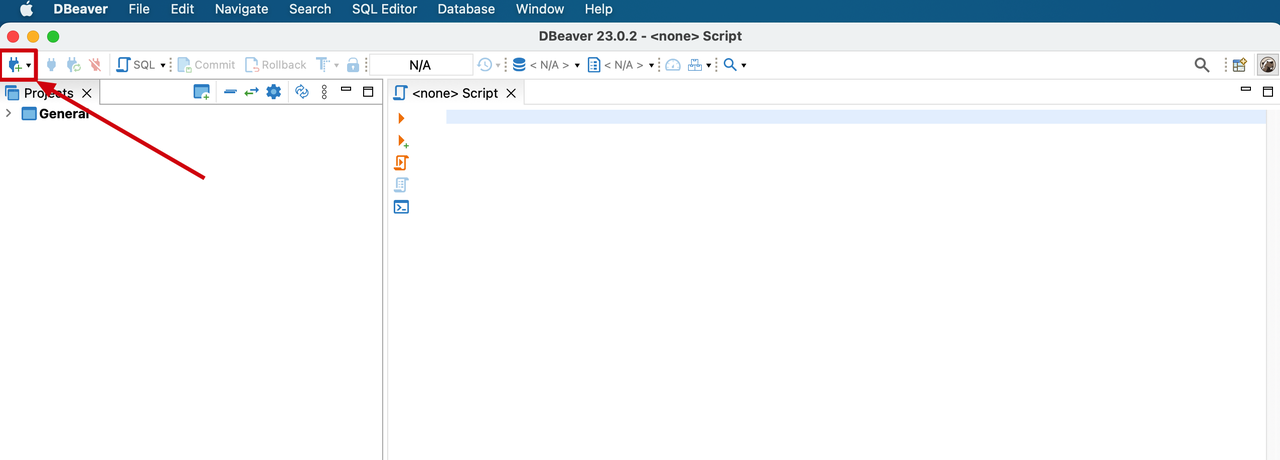

  1. Launch DBeaver.

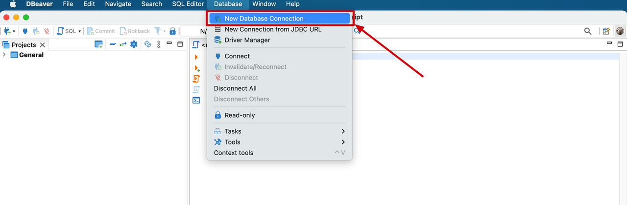

  2. Click the plus sign (+) icon in the upper-left corner of the DBeaver window or choose Database > New Database Connection in the menu bar to access the assistant.
    DBeaver - Access the assistant

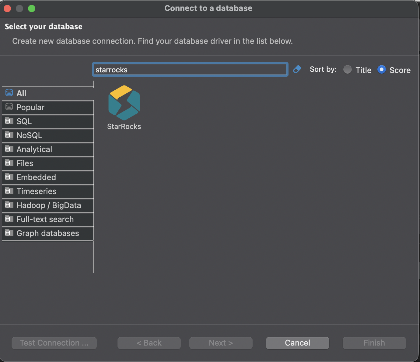

  3. Select the StarRocks driver.
    In the Select your database step, you are presented with a list of available drivers. Search for StarRocks in the search bar, or click Analytical in the left-side pane to locate it. Then, double-click the StarRocks icon.

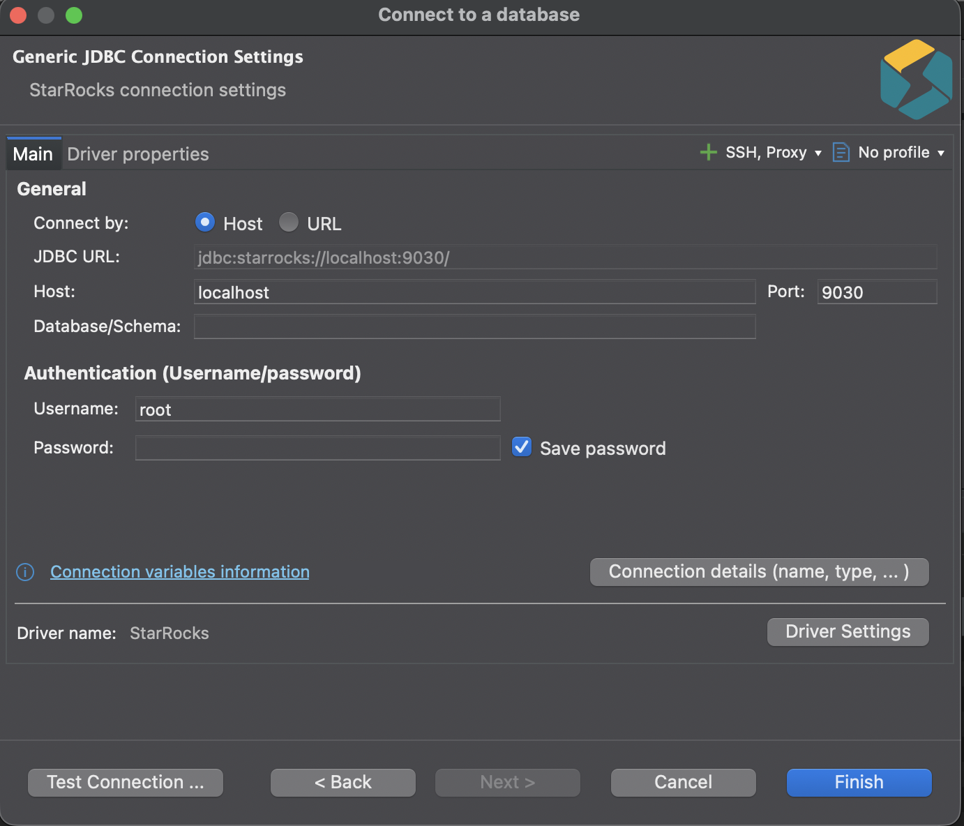

  4. Configure the connection to the database.
    In the Connection Settings step, go to the Main tab and configure the following essential connection settings:
    • Host: the FE host IP address of your StarRocks cluster.
    • Port: the FE query port of your StarRocks cluster, for example, 9030.
    • Database/Schema: the target database in your StarRocks cluster.
    • Username: the username that is used to log in to your StarRocks cluster, for example, admin.
    • Password: the password that is used to log in to your StarRocks cluster.

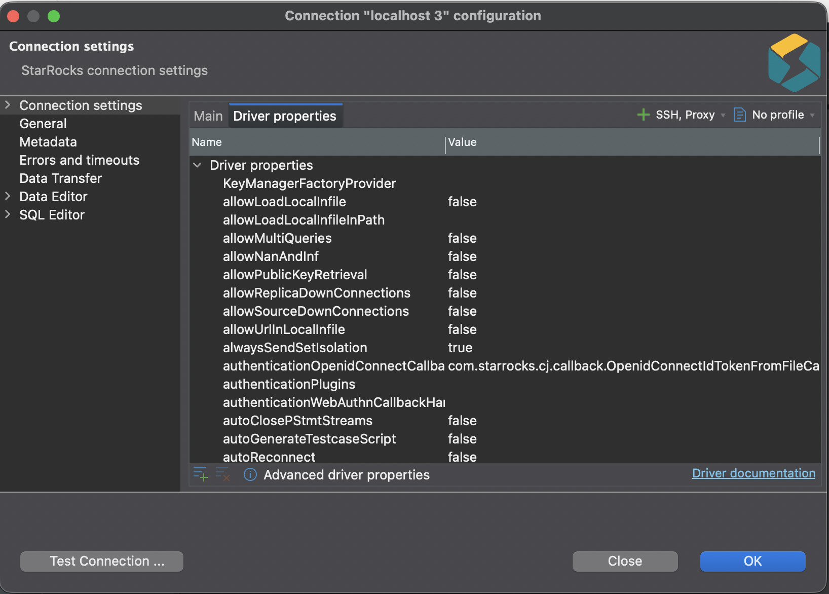

    You can also view and edit the properties of the StarRocks driver on the Driver properties tab if necessary. To edit a specific property, click the row in the Value column for that property.
    DBeaver - Connection Settings - Driver properties tab

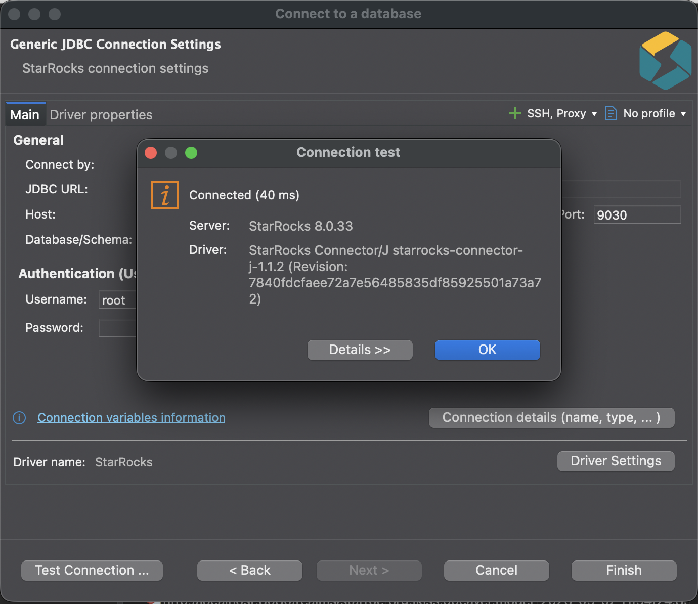

  5. Test the connection to the database.
    Click Test Connection to verify the accuracy of the connection settings. A dialog box displaying the StarRocks driver's information appears. Click OK in the dialog box to confirm the information. After you have successfully configured the connection settings, click Finish to complete the process.

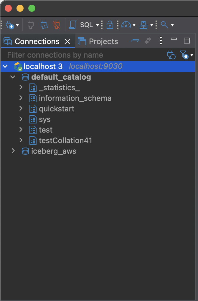

  6. Connect to the database.
    After the connection is established, you can view it in the left-side database connection tree and DBeaver can effectively connect to the database.
